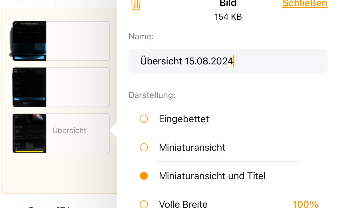

Inserted image has no title in the thumbnail view
  • I have inserted images from the media library
  • Changed the view to thumbnail +title
  • The thumbnails are displayed but without titles
  • I have changed the titles
  • The title is only displayed for one thumbnail, but not completely. No title is displayed for the other 2.
The titles are visible as inline:
I always want to see the title in the view.
I inserted the images on the iPad and changed the titles there too. It didn’t work after several attempts.
Then tried again on the iPhone and even restarted the device. Problem remains and is reproducible when inserting new images.
Edit: The same problem with older notes with images and other attachments.
iPadOS/iOS 17.6.1, Agenda 19.0

The text file is renamed in the Name field. No title visible afterwards either:
Crazy! This view works:
Some attachments with longer titles only show the first 1 or 2 words. It seems to be a limited number of characters and believe the agenda standard, so not a bug.
Edit:
Changed the title here to “15.08.2024”. Nothing is displayed:
Then changed to “Übersicht 15.08.2024”. And now "Übersicht“ is visible:

Only the titles that are longer seem to be shown at the moment. Short titles with only 1 word are invisible. If I reduce long and visible (shortened) titles with several words to 1 word, the title is then invisible.

Hi @drewmccormack,
I think I have found something.
If I change the font to Avenir Next (default) on the iPad in Agenda settings, the titles are visible again on both devices. This also applies to all default fonts except “Atkinson Hyperlegible”.
The font “Atkinson Hyperlegible” is the first problem.
I actually think it’s very good and activated it immediately after implementation, so it’s been a while.
However, there are also other problems with the “Thumbnail and title” display.
  1. changed the font on the iPad to Default in the Agenda settings
  2. the setting is synchronized after 3-5s on the iPhone. (My wish would be not to change this :face_with_monocle:)
  3. the font is then the same on both devices, but not for the titles of the thumbnails.
  4. only when I re-edit a title on the iPhone, the font is then only adjusted for that.
  5. changing the font on the iPhone corrects the font of all titles again
See an example here.
I can see this on the iPad immediately after changing the font:
…and this is what I see on the iPhone after I have edited the title above.
I previously changed the font on the iPhone several times for testing purposes.
The font of the titles in the middle and at the bottom hangs until the font is changed again on the iPhone.
View on iPhone after I change the font setting synchronized from iPad to another e.g. Charter. This change makes all titles appear correctly again.
The second problem is the synchronization of the Agenda font settings.
Ok. I now also understand why I could see the titles in some old notes. I still typed them in the default font.
What I don’t understand is why it feels like the new font (AtkH) has only been causing problems since July. I’ve been using it on the iPhone for a long time and I didn’t notice the problems before.
