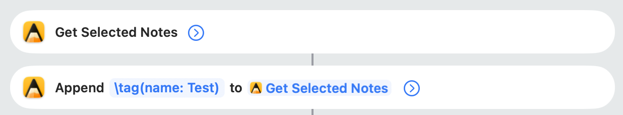

For the \tag() notation: It seems to me that using this in Shortcuts is kind of blocked currently. In the app it works just fine.
This shortcut appends nothing to the note:

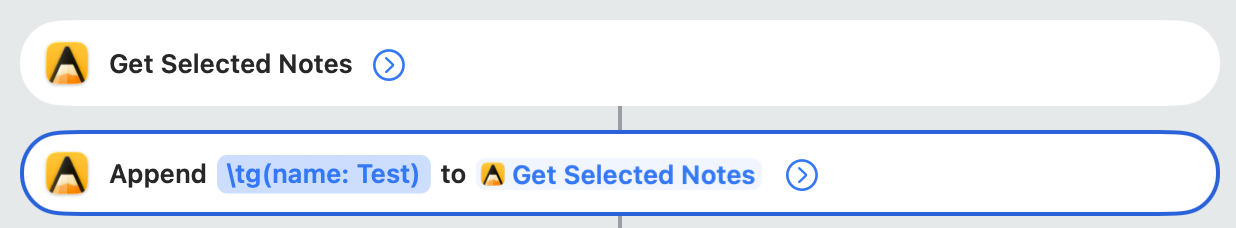

While the following appends β€œ\tg(name: Test)β€œ to the note:
