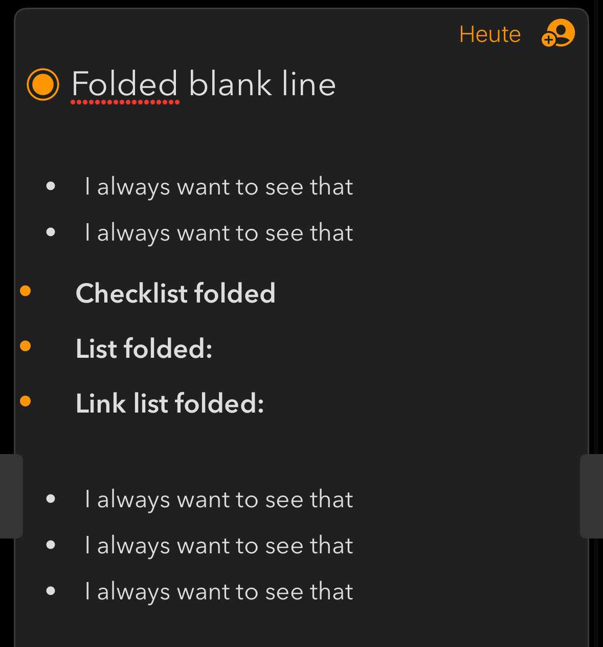

Okay, but how do I create a note like that so that I can easily add to it later?
Edit and expand right here:
By pressing rtn anywhere but the beginning of a header line will give you an empty space below it. So in your case you rtn from the end of the collapsed “Link list folded”.BTW Im on a Mac.
I couldn’t do it that way on the iPhone.
I tried for a long time, and it felt very complicated to create a simple note with collapsed content.
I then inserted a blank line below “Link list folded:” and formatted it as an H1 heading.
This achieved my goal for the time being. However, if I want to edit that section later and add more text, the structure is quickly destroyed.

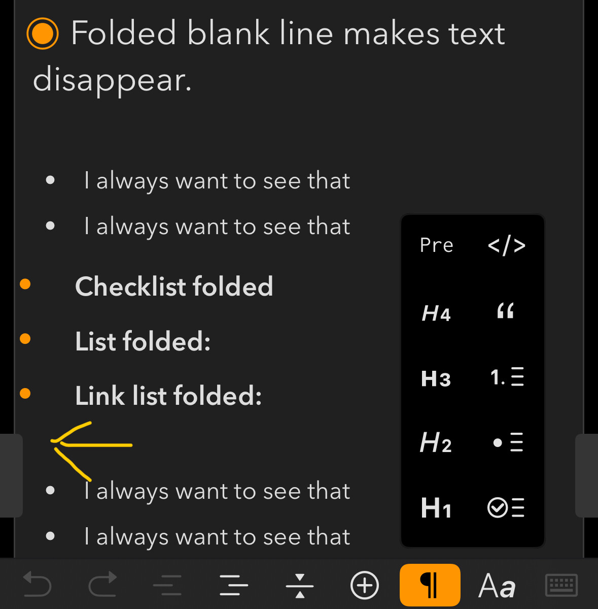

The H1 formatting is then no longer recognizable (see second image).
I often have similar problems with notes with collapsed sections. Later changes change the structure, and then I don’t see what I want to see.
I don’t want to worry about what needs to be taken into account when collapsing a section.
