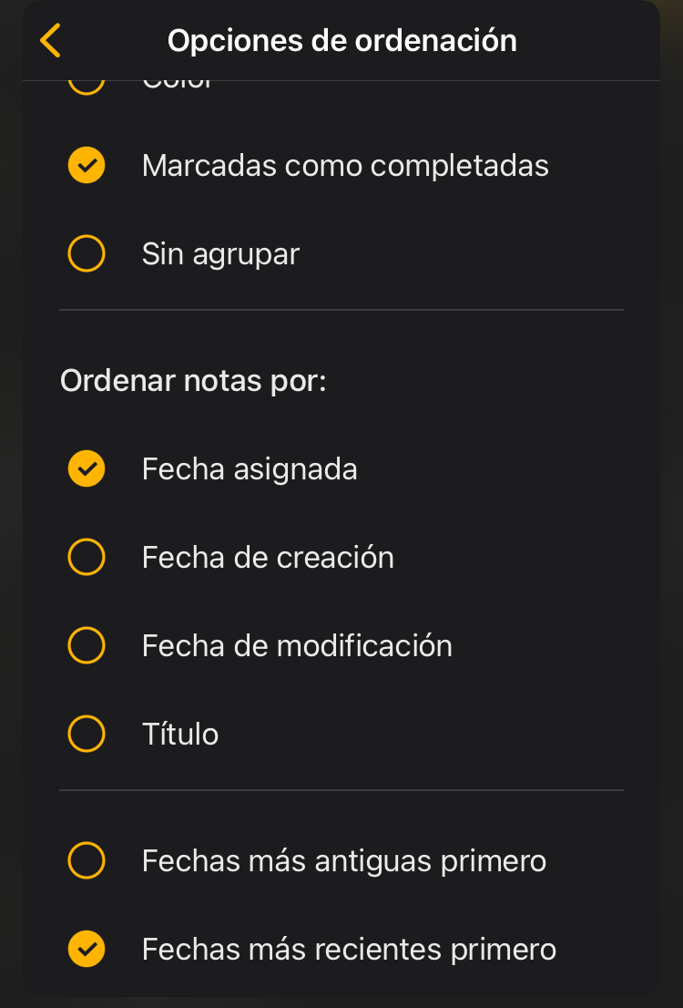

I set sorted grouped by completed, order by assigned date.

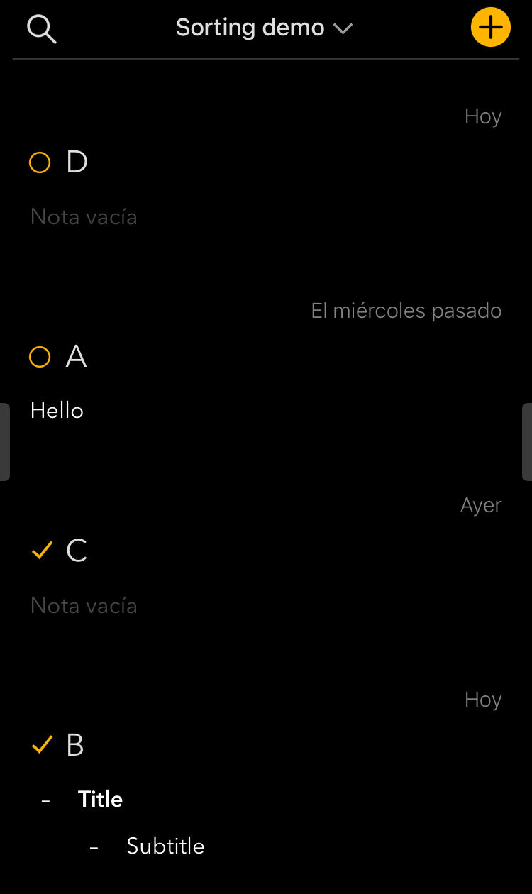

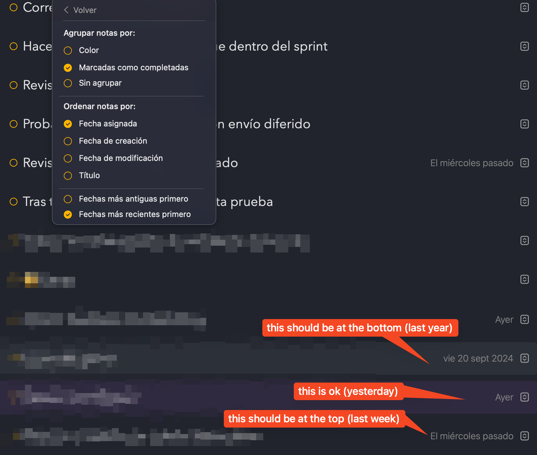

Added a capture but the captions are wrong sorry :smiling_face_with_tear:
It should be yesterday, then last week and finally last year at the bottom.
Forgot to mention last 4 notes are completed I added so much blur, the rest are not. So the top one from yesterday is wrong too.
Maybe I should add a better screenshot.
Maybe here is easier to spot. I made this on my phone.
Uncompleted notes are ok but completed notes should the other way around right ?
Sorry to keep adding responses I can’t find how to edit messages. I forgot to mention I created the notes alphabetically just in case creation date matters. So A, B, C and then D.
Are you sure the order is wrong? I see notes grouped by completion, with the completed ones at the bottom. And within each group (completed/incomplete), it sorts them by assigned date (ie Hoy is after El miércoles pasado).
What am I missing?

Update: Ah, I see now. The completed ones should indeed be reversed, I would think. And there is nothing else of importance, like using pinned?

I think is really using the label of the “date” instead of the internal date for sorting. Just checked again and it makes sense. The order matches the text of the date alphabetically.
  • Completed notes: Hoy → Ayer
  • Uncompleted notes: El miércoles pasado → Hoy
That would explain why everyday I find my notes in a different order.
