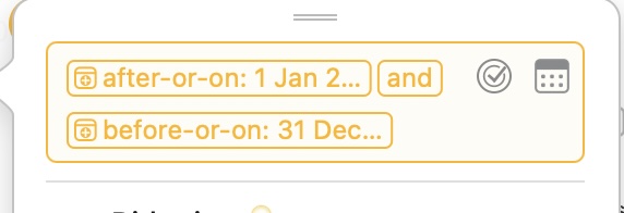

Unfortunately, it doesn’t appear to be functioning for me. When I conduct a search for the year 2023, it retrieves notes from 2022 or 2021, as well as from 2023. Could it be possible that my database is corrupted? If that’s the case, is there a method to rebuild it?
Did you setup the search like I described? Note that the creation-date is not the same as the date you add to the note. Can you perhaps post a screenshot of the search you made?
I think it is unlikely that your database is corrupted. More likely there is a bug in search. But let me know, and I’ll see if I can track it down.
I’m afraid there’s a bug with the search feature. Here’s a screenshot of my search as requested. It’s easy for me to test this because I only have four notes from 2023, as I didn’t use Agenda that year (I had to switch to Windows).

It couldn’t have anything to do with the “and” term there right? I think that is just matching the word “and”, not making a logical AND.
By default, searches with multiple tokens will use AND. You can change that by clicking on the tokens and setting them to “optional” in the filter mode.

Understood. After making several attempts to search for notes by creation date, I unfortunately have to say that the search doesn’t yield the expected results. There is probably some technical intervention needed at the level of the search engine.
OK, I’ll investigate. So the problem is searching for two date ranges and-ed together, correct?
Correct. Creation dates, not other date types.
I have made some changes, and tested, and I think this is working now. Will be in the next minor update, so please do check it.
