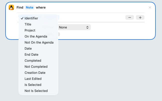

May I request Tags as a filter for the Find Notes Shortcuts action.
Thanks for the feedback!
Are you sure you can’t already search for tags?
I was thinking I could use a Tags filter here. But I will try a different approach by iterating through each note looking for tags using the Get Tagged Items action.
Does it work to search for #tag?
In agenda, tags are note content, rather than properties of the note itself.
I don’t see a way to search note content in Apple Shortcuts, other than iterating through the notes and using the Get Note Text for each one.
What I’m trying to do is use Shortcuts to automate a spaced repetition routine where I, for example, find all notes tagged containing the tag #weekly that were completed over a week ago, then mark them as incomplete and on-the-agenda.

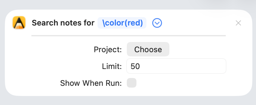

Is it possible to search by colour? I’ve tried \colour(red) as a query for the Search notes action without any luck.
What color do you mean? Background color?
I just tested the normal search, and it did find notes with the same background color based on \color(blue). Is that at least working for you?
Are you saying it does work in the normal search, but not via the shortcut? I would think it should but would need to check.
Yes, I meant the background colour via the shortcut. It doesn’t find any matching notes.
OK, will investigate.

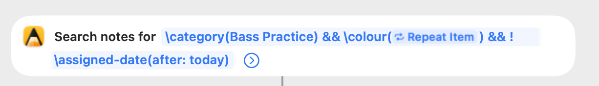

One more question, for this Search action, I want to exclude any notes that are assigned to a date in the future (so only include undated or assigned to a past date). But the following queries fails to exclude those notes. Any ideas?
I also tried this, which successfully excludes notes assigned to a future date, but fails to include those with no assigned date.

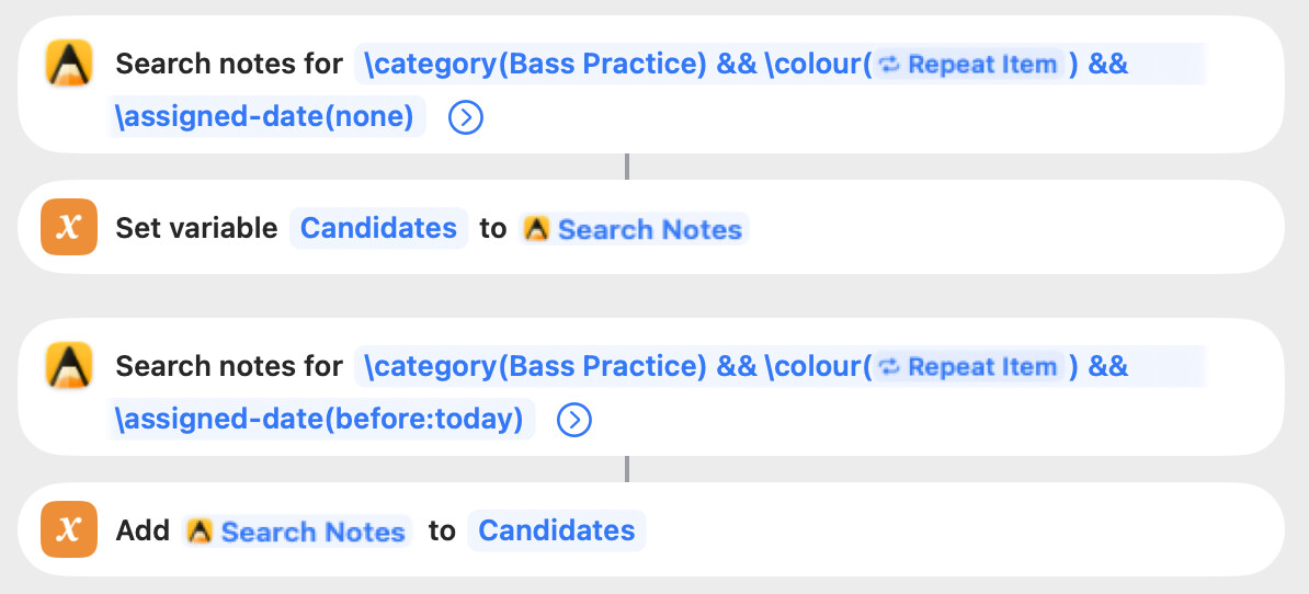

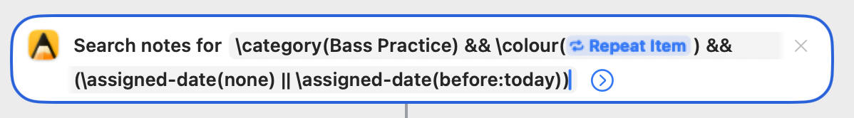

OK, I think I found a solution. It appears that || and ! operators and parentheses grouping aren’t actually supported in the expressions for the Search notes Shortcut action. I was only able to get this far by trial and error, so may I kindly implore you to add some documentation above? :slight_smile:
Thanks, and good detective work.
You are right that the Search notes Shortcuts action does not support the same full expression syntax as the in-app search field. I will try to bring them into parity in a future version.
Note that full grouping support is not even supported in the search field. Agenda has a different approach to the standard boolean operators, with required/optional settings for each term.

In the meantime, since what you want is really “past-dated OR undated”, the cleanest workaround is to run two Search Notes actions and merge their results: one with \date(before: today) for notes assigned to a past date, and one with \has-assigned-date(no) for notes with no date at all. Combine the two lists in your Shortcut and you’ll get everything except future-dated notes.
