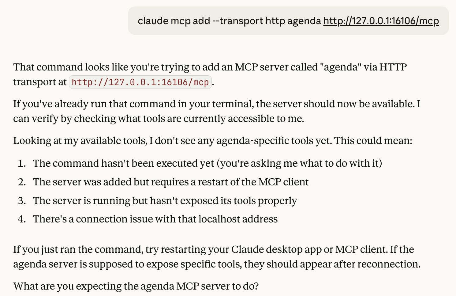

Claude desktop says:
Alternately, pasting the command in terminal as Claude suggests, fails.

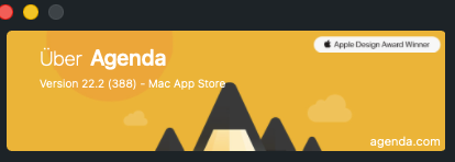

Hi drew,
I’m feeling a bit stupid, but I just updated to Agenda 22.2 and I don’t see the Agenda > Integrations menu anywhere. Where is it supposed to be?
Nope. Adding that code to the json errors out. Claude explained why:
The JSON is valid now — the problem is that Claude Desktop doesn’t recognize "type": "http" as a valid MCP server transport in its config format.
Claude Desktop’s claude_desktop_config.json supports two MCP server types:
  1. stdio — requires "command" and optionally "args" and "env" (like your Readwise entry)
  2. sse — requires "url" pointing to a Server-Sent Events endpoint
Your “agenda” block uses "type": "http" which isn’t a supported transport. Try changing it to:
"agenda": {
  "type": "sse",
  "url": "http://127.0.0.1:16106/mcp"
If the agenda server actually speaks raw HTTP (request/response) rather than SSE (streaming), then Claude Desktop may not support it natively yet. In that case you’d need a proxy or adapter that bridges HTTP to stdio or SSE. But try "sse" first — many MCP servers that expose an HTTP endpoint are actually SSE under the hood.
The error is clear: Claude Desktop is looking at mcpServers.agenda.command and finding it undefined. It expects every MCP server entry to have a "command" field (stdio format). It doesn’t support "type": "sse" or "type": "http" at all — at least not in your version.
So Claude Desktop simply doesn’t support URL-based/remote MCP servers in its config. Every server must be a local process it can spawn.

Claude says it won’t accept url as a valid protocol scheme.
Yeah, I’ll see what I can do. It’s tricky with a sandboxed app. Every other MCP server I’m seen for Mac app has been this HTTP type.
I’ll leave the final word to Claude Desktop itself…
The irony is that the HTTP/SSE approach is actually the right architecture for a sandboxed Mac app. Agenda can spin up a local server on a port, stay within its sandbox, and serve MCP that way. It’s Claude Desktop that’s the bottleneck by not supporting remote transports yet.

Hi drew,
thank you for the quick turnaround on that.
I have to come back to may question: I don’t see the integrations option in my Agenda menu:
I’m updated to 22.2, restarted Agenda multiple and also restarted my Mac. Do I have to do something else to be able to see the integrations menu?

This has something to do with the language version.
Agenda > Integration is also missing in my German version.
